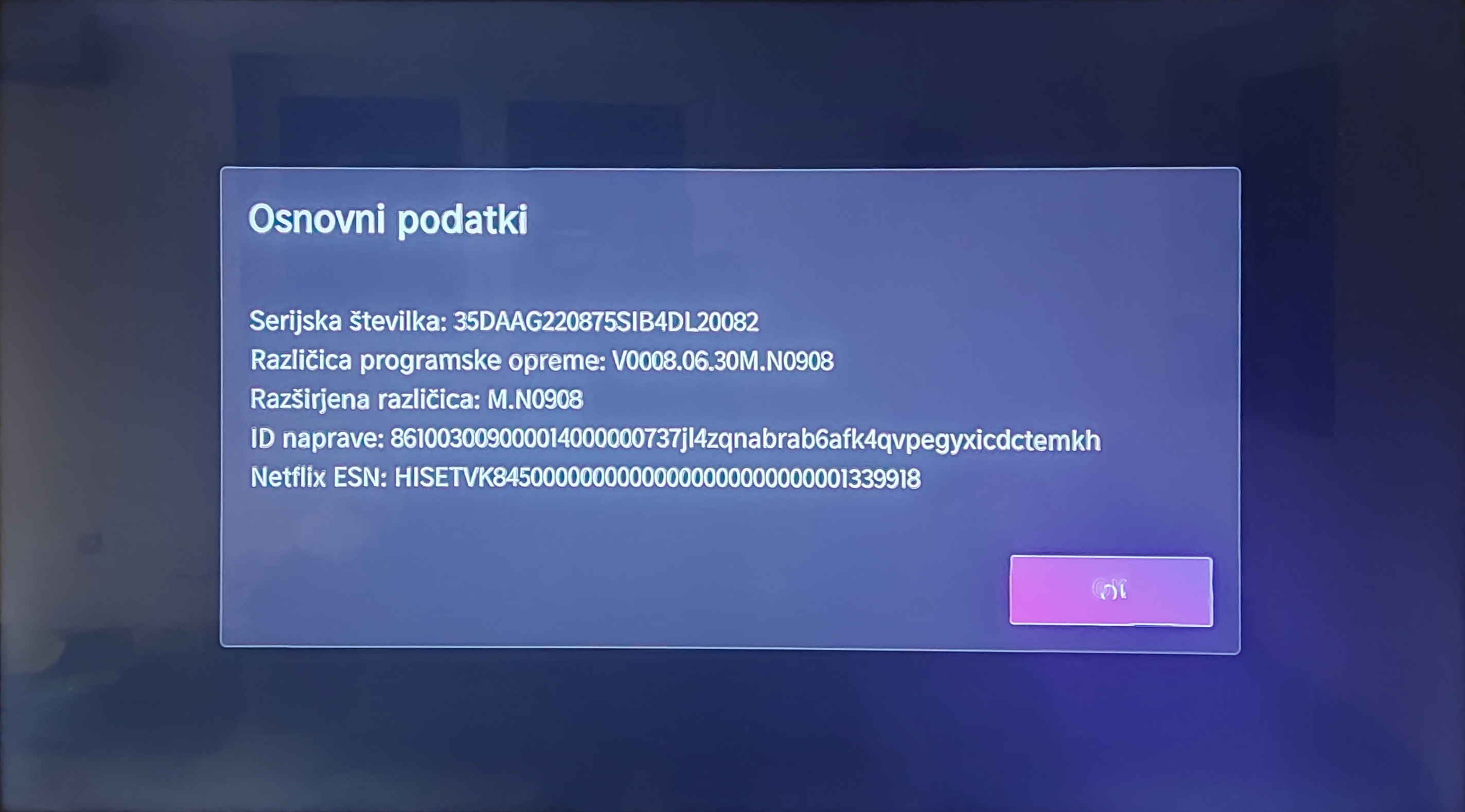

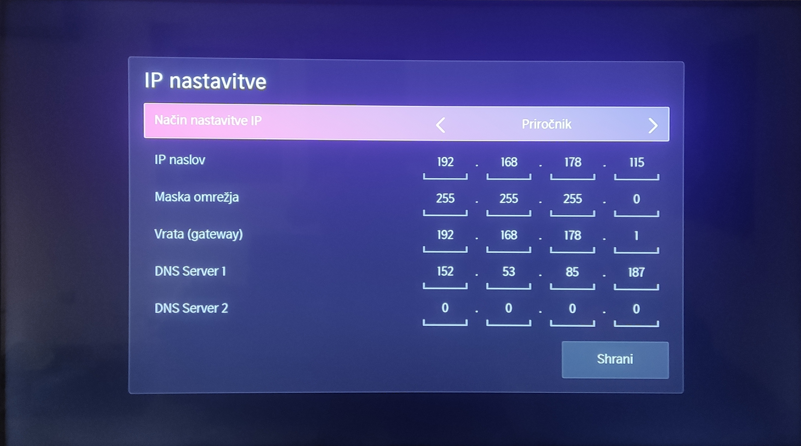

I'm also playing with my Hisense and I get a blank screen. DNS on my Adguard is set to resolve vidaahub with the provided DNS and on my mobile phone it reaches the correct page. Probably my chromium version is even older, Is there a way to check? My tv is a H55U7B running V0000.01.00a.N0608
Thanks

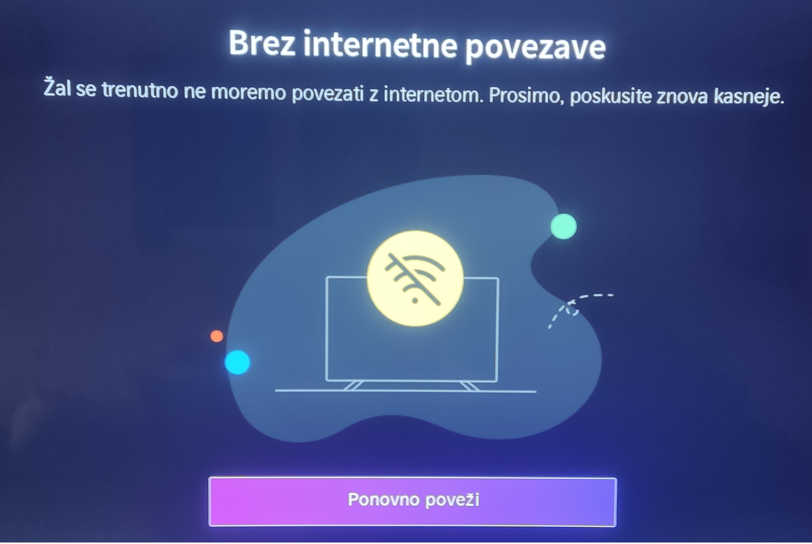

2025-02-20, 08:51 AM
Installed, restarted tv, the app is showing, reconnected to network, started app. The app says no internet connectinon, but it works in browser with same ip-addres. I also tried with https://my.ip, nothing works.
