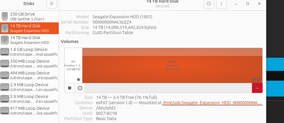

    I realized I also have an exFAT drive which should mount the same
    Here's the disk
    Turns out the NTFS drives stopped being seen by my device completely and even my bios isn't detecting so I'm gonna need to reseat them and the cables and figure out what is causing those to be an issue but the external drives have a lot of media on them I care more about then the other internal SSD's anyways and if I just mounted improperly somewhere that Should be the same process regardless and if needed nothing important is on the internal drives as it's all been backed up to my NAS anyways so I'm not terribly worried about them

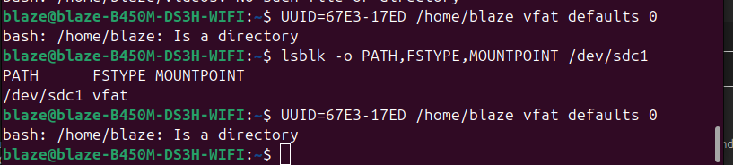

    2024-09-16, 05:58 AM (This post was last modified: 2024-09-16, 08:59 AM by Blaze. Edited 4 times in total.)
    Power cycled the system and everything works despite the errors. No clue how that fixed it, but thank you for all the help along the way
    I've been reading and working through the mounting guide, but I have gotten stuck on litterally the last step and was hoping you might be able to shed some light for me?
    blaze@blaze-B450M-DS3H-WIFI:~$ sudo fdisk -lx
    Disk /dev/loop0: 74.24 MiB, 77844480 bytes, 152040 sectors
    Units: sectors of 1 * 512 = 512 bytes
    Sector size (logical/physical): 512 bytes / 512 bytes
    I/O size (minimum/optimal): 512 bytes / 512 bytes
    meant to send this as a screenshot my appologies. I couldn't get the UUID and first partition to work so this was just my attempt to get something to work
    blaze@blaze-B450M-DS3H-WIFI:~$ lsblk -o PATH,FSTYPE,MOUNTPOINT /dev/sdc2
    PATH FSTYPE MOUNTPOINT
    /dev/sdc2 ext4 /media/blaze/TV&MOVIES

    Disk /dev/sdc: 12.73 TiB, 14000519642624 bytes, 27344764927 sectors
    Disk model: Expansion HDD
    Sector size (logical/physical): 512 bytes / 4096 bytes
    I/O size (minimum/optimal): 4096 bytes / 4096 bytes
    Disklabel type: gpt
    Disk identifier: 01000000-0000-0000-4E41-43364C455A34
    First usable LBA: 34
    Last usable LBA: 27344764893
    Alternative LBA: 27344764926
    Partition entries starting LBA: 2
    Allocated partition entries: 128
    Partition entries ending LBA: 33
    Device      Start        End    Sectors Type-UUID                            UUID                                Name                Attrs
    /dev/sdc1      40      409639      409600 C12A7328-F81F-11D2-BA4B-00A0C93EC93B 81A5D46D-2DBF-455A-A3B5-7EF2BE05474C EFI System Partition
    /dev/sdc2  411648 27344762879 27344351232 0FC63DAF-8483-4772-8E79-3D69D8477DE4 4F2BB852-4E22-4A34-A814-E889FA93D2FE

    Disk /dev/sdd: 12.73 TiB, 14000519642624 bytes, 27344764927 sectors
    Disklabel type: gpt
    Disk identifier: 01000000-0000-0000-4E41-43364C363953
    /dev/sdd1      40      409639      409600 C12A7328-F81F-11D2-BA4B-00A0C93EC93B A44A6550-6FCC-4DC2-91C7-E2DDDF908BF9 EFI System Partition
    /dev/sdd2  411648 27344762879 27344351232 EBD0A0A2-B9E5-4433-87C0-68B6B72699C7 88AC0EAC-99BD-4E3B-9013-0FA1DA58948B

    edit: Got the proper UUID for the partition and just need to figure out what is causing this command to fail UUID=233aa4b4-aced-44bf-9206-b8ca19c44468 /media/jellymount ext4 default 0 0
    bash: /media/jellymount: Is a directory
    Reputation: 463
    #17
    2024-09-16, 03:15 PM
    The fdisk command shows that sdc2's UUID is 4F2BB852-4E22-4A34-A814-E889FA93D2FE. Try using that.
