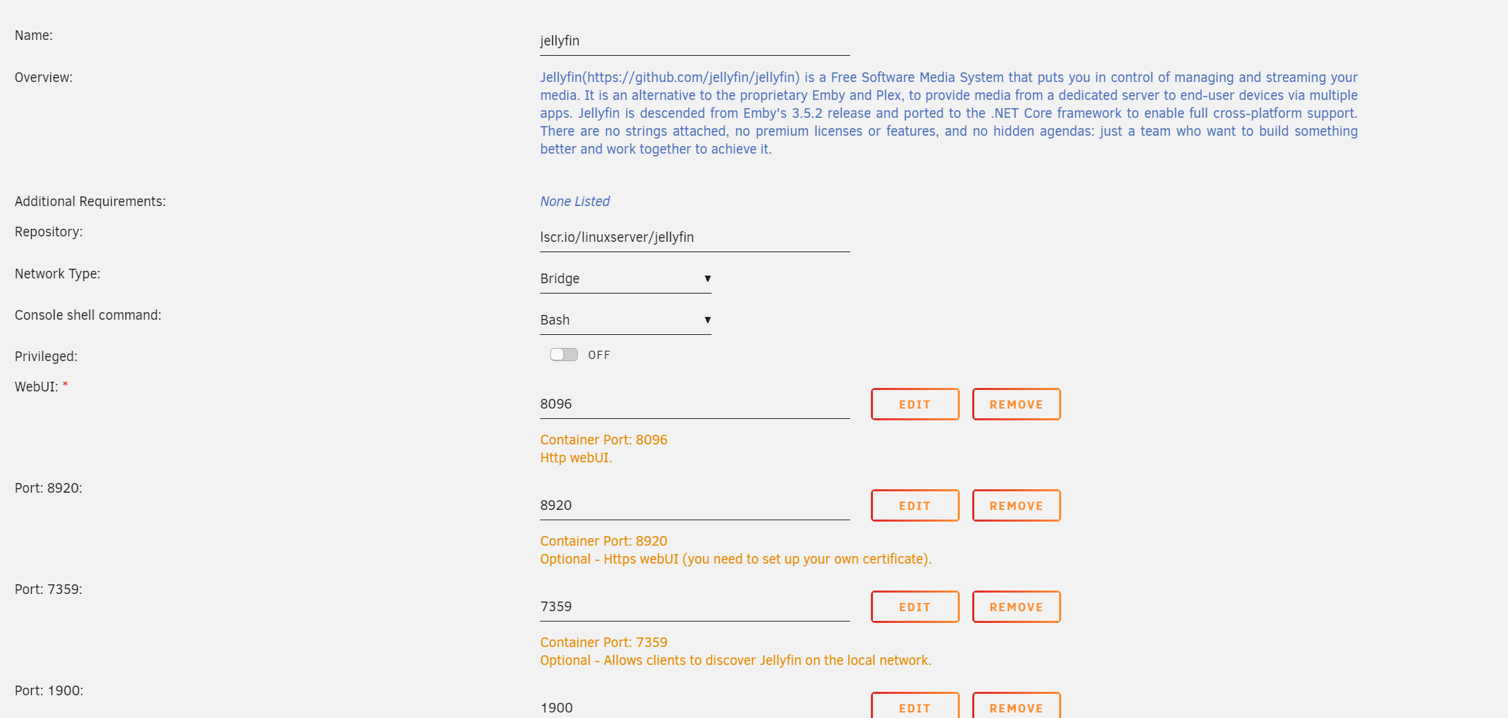

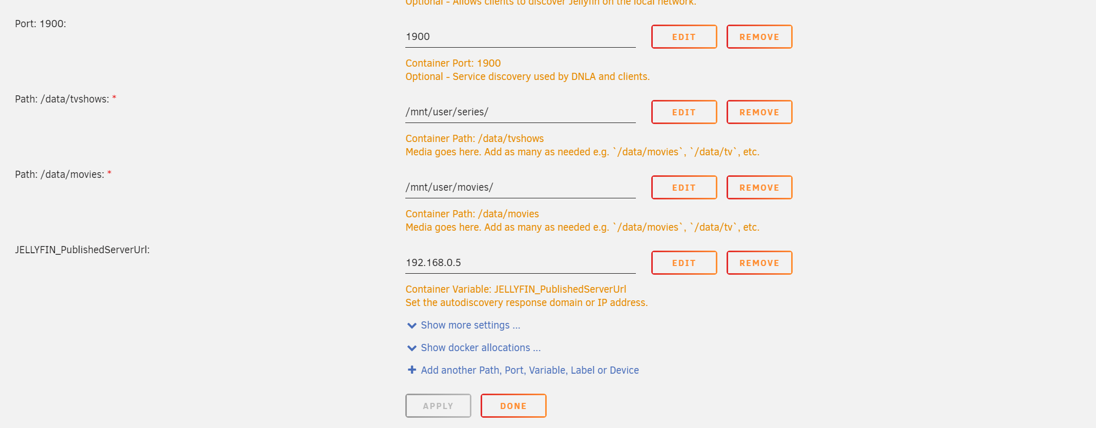

    2024-08-21, 03:56 PM
    Can you share screenshots of the Docker container's settings from the unRAID UI?
    ninjapower14
    Posts: 7
    2024-08-22, 03:01 PM (This post was last modified: 2024-08-22, 03:03 PM by ninjapower14. Edited 1 time in total.)
    Here's my jellyfin docker settings.

    2024-08-22, 04:04 PM
    You need to add a device and pass in /dev/dri/renderD128.
