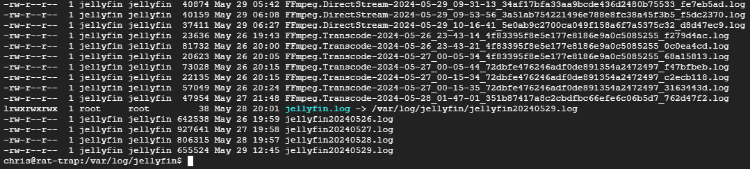

    Ok.  I looked over your logs again.  The ffmpeg lines in the main log that are failing are transcodes, but all the ffmpeg files you've shared are remuxes.
    In the log directory there should be ffmpeg logs with "Transcode" in the file name.  Can you find and share one of those?

    (2024-05-29, 05:14 PM)TheDreadPirate Wrote: Ok.  I looked over your logs again.  The ffmpeg lines in the main log that are failing are transcodes, but all the ffmpeg files you've shared are remuxes.
    Okay so I turned off the AV1 encoding so hopefully that is fixed. However I played an episode and generated some new logs and I notice that the only logs available are jellyfin.log and FFmpeg.Remux.log there is no transcoding log made. So I assume that the player doesnt have any need to transcode at the time or perhaps doesnt get the opportunity to do so? I am playing this off of my main PC which has a 3090 TI and a Ryzen Threadripper 5975.
    Never used pastebin before so hopefully I did this right? edit: I lied i was able to change the resolution after thinking about it the video was in 1080 and i played it in 1080 so it had no need to transcode so I switched it to 480 and got a log
    https://pastebin.com/MqKBNY6y
