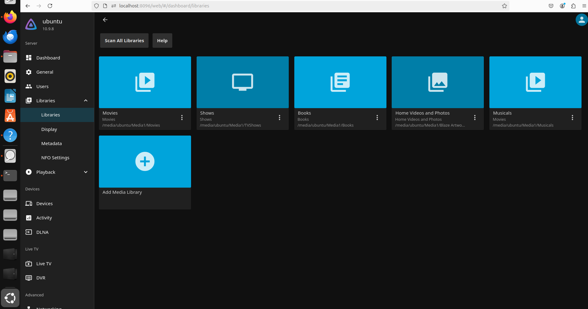

    2024-09-09, 11:40 AM
    So I have gotten Jellyfin up and running on the latest version of Unbuntu but am running into a permissions issue I have never faced before where it seems my mounted external NTFS drives don't have permission to be read by Jellyfin. I've tried changing my mount settings but it seems my 14tb partitions are being ignored regardless.
    If you aren't able to help I'll figure it out eventually, but it's been a couple years since I decided to use debian and I definitely am not as competent as I once was

    2024-09-09, 02:42 PM
    How did you mount your NTFS drive? Run this command and share the output.
    mount | grep ntfs
